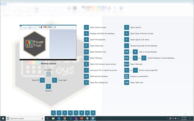

As for these new Windows 10 Power Toys, here’s what the Windows key shortcut guide looks like:
PowerToys - Shortcut Guide
